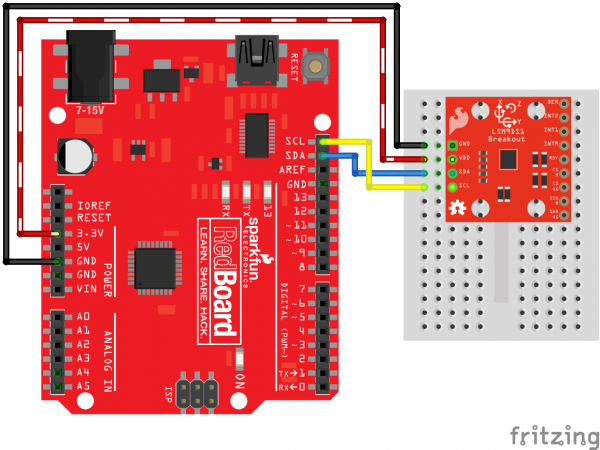

To read Acc, Gyr and Mag data from LSM9DS1 IMU 9DOF board there is no need to use X-Nucleo-IKS01A2 board.
- At ST MEMS Standard C drivers Github repository there are drivers and simple examples for each supported sensor. Directory lsm9ds1_STdC contains necessary driver files and example files for LSM9DS1 IMU 9DOF board.
- Use NUCLEO-F411RE and properly wire LSM9DS1 IMU 9DOF board to it. Usually pins GND, VDD, SDA, SCL should be enough:
- Use lsm9ds1_STdC/examples/lsm9ds1_read_data_polling.c example code as a main application file to run example. Note: With minor modification of example code it is possible to use NUCLEO-L053R8 board

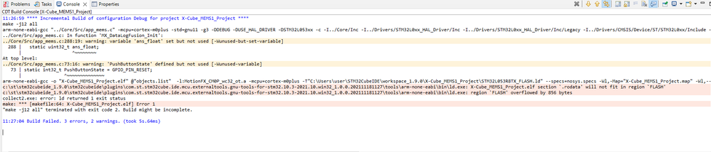

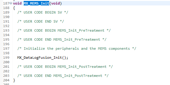

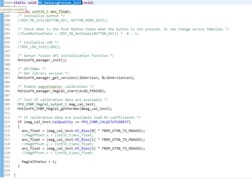

I've tried using MEMS_Init function attached below. But now I'm observing FLASH Overflow error. I have not used BSP type functions. Is there any setting/process to overcome this error. Go through the attached images and Please help me to resolve this error.
Any help would be very thankful.
‎2022-06-01 2:57 AM
L0 has very limited memory and MotionFX is quite demanding library so it's not the best combination. If you haven't already tried you can turn on the optimization for size and also try to avoid using too many global variables initialized to the non-zero values. You can use the DataLogFusion application for Nucleo-L073RZ in the X-CUBE-MEMS1 package as a reference.

‎2022-07-15 8:52 AM
‎2022-08-01 3:21 AM
Thank you @Martin B​ ,
I tried with the provided example now it is working as expected.
