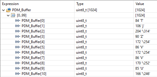

I'm using a stm32wb55RG. I'm trying to get data from a MEMS PDM microphone and convert it into PCM data. I'm using SAI PDM interface and DMA. So far, I think I manage to receive the PDM data (I get some values from the SAI interface) :
0693W00000KbvY4QAJ.pngI don't know if these values make a sense or not. But when I try to convert these data into PCM using PDM_Filter, I can't get any value in the output buffer.
I provide the code :

TL DR : Using this : PDM_Filter(&PDM_Buffer[0], &mid_Buffer[0], &PDM_FilterHandler); mid_buffer is stuck to 0 and I don't understand where the problem comes from
