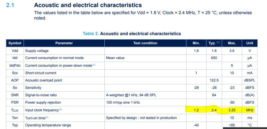

Now, this 1,024MHz is outside IMP34DT05 requirements and may explain behavior. As mentioned in previous post, this mic_clock must be higher than 1,2Mhz and below 3,25MHz
=> Here, you need to increase this clock frequency. It could explain behavior your notice.

Let me also highlight one more time that clock value you are using is out of IMP34DT05 specifications from datasheet. Behavior can not be guarantee ( it may probably works with most of samples but some will not be functional at this 1,024Mhz clock frequency.)
