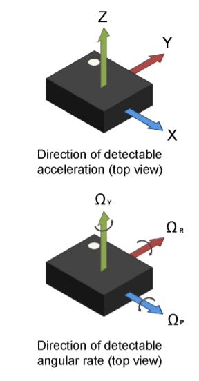

Hi @BDiva.1​ ,
since it is reported in two's complement, it is a signed value (the physical principle interpretation is that acceleration can be negative if it is in the opposite verse -for example- of the earth gravity). You can check the direction of the acceleration / angular speed from the picture in the datasheet p.6:
LSB-to-physical units conversion formula (for the accelerometer) is the following one (lsm6dso_reg.c:(
float_t lsm6dso_from_fs2_to_mg(int16_t lsb)
return ((float_t)lsb) * 0.061f;

‎2021-04-07 12:20 AM
Hi @BDiva.1​ ,
If my reply answered your question, please click on Select as Best at the bottom of this post. This will help other users with the same issue to find the answer faster.
