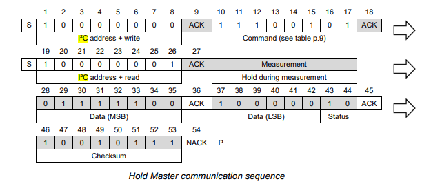

I'm trying to get the sensor value with stm32
Maybe because I connected the board to one i2c and attached two sensors, the value didn't change
Most people use cereal, but I only use C, so I have to use HAL
The sensor that allows you to read only one is HTU21
I'm doing this and that, but I only got 01 00 00 00 00
I think I didn't code properly, but I don't know where to fix it
I want to get the sensor value and use it as a hex value and float value, so please tell me how
uint8_t hum_addr = 0x40;
uint8_t hum_sec_addr = 0xE5;
uint8_t buf[5] = {0x01, 0x00 };
uint8_t R_buffer1[5] = {0x01, 0x00 };
uint8_t R_buffer2[5] = {0x00, 0x00 };
HAL_StatusTypeDef ret;
//ret = HAL_I2C_Master_Transmit_IT(&hi2c1, (uint16_t)hum_addr, (uint8_t*)R_buffer1, 2);
//ret = HAL_I2C_Master_Receive_IT(&hi2c1, (uint16_t)hum_addr, (uint8_t*)R_buffer2, 2);
ret = HAL_I2C_Mem_Read_IT(&hi2c1, (uint16_t)(hum_addr << 1), hum_sec_addr, 1, R_buffer2, 5);

Hello @ark​,
I suggest you try to use the I2C sensor address without shift:
HAL_I2C_Mem_Read_IT(&hi2c1, (uint16_t) hum_addr , hum_sec_addr, 1, R_buffer2, 5);

‎2022-11-01 6:34 AM
0xE5 doesn't seem like it can be a valid address.
‎2022-11-01 6:45 AM
It's a measurement command (Temperature) for the read.
Foued
‎2022-11-01 9:12 AM
Take an oscilloscope (not a logic analyser guys) and observe the i2c bus. Monitor the slave address ack bit.
‎2022-11-01 12:26 PM
The code doesn't appear to provide the 7 to 50 msec Hold during measurement. See page 5 of the data sheet.
(Edit) You might try asking for example code as stated on data sheet page 10. The data sheet date is 9 years ago, so there may be no response.
