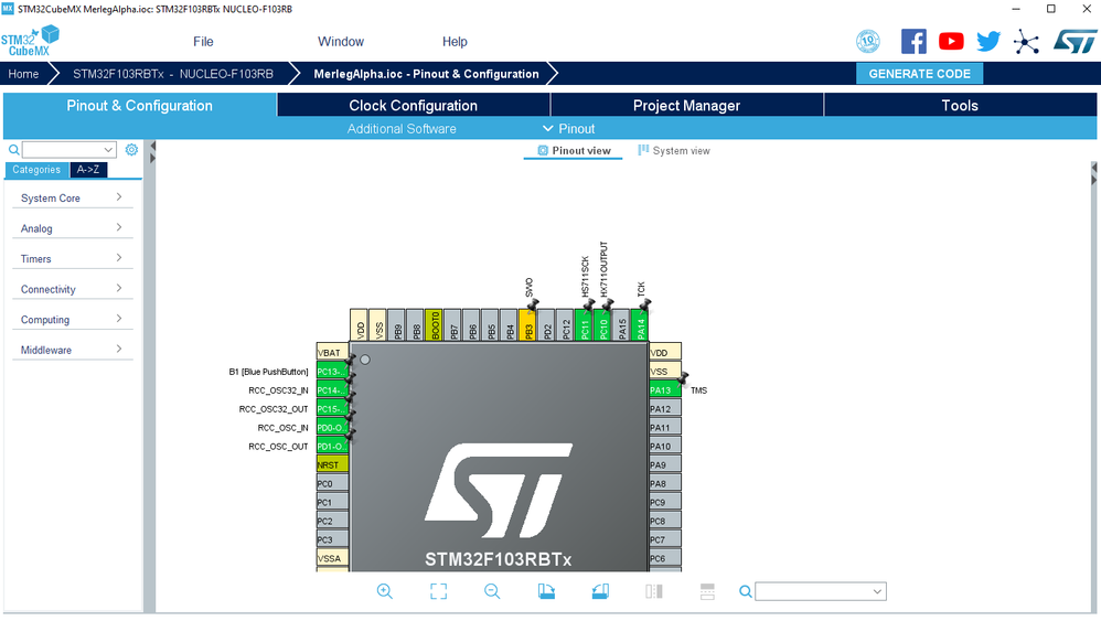

Hey!
I am a newby, but i am i a school project where i have to do a scale.
I set up the hx711 and the load cell with my nucleo card, but the card does not se
d clock signal to the hx711.
I am using a hx711 library i found at:
github.com/freakone/HX711
Could you please help me?!:folded_hands:
Thanks in advance.​
‎2019-11-28 10:07 AM
‎2019-11-28 10:17 AM
Of course,
I use CubeMX to configurate the pins as u can see in the first picture.
And here is my code:

And it retuns 8388608 in the meres variable.
Thanks for helping me!
