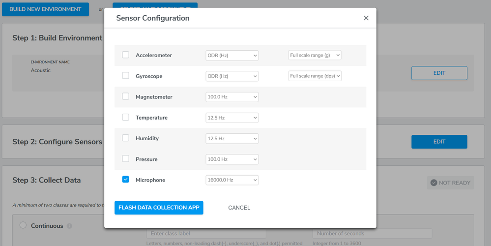

Is it possible to do wake word detection on SensorTile Box?
ShivaRagu
Senior
Eleon BORLINI
Hi @ShivaRagu​ ,
I believe it is possible, even if not so straightforward. You might refer to the general solution provided by ST, that however runs on STM32H7, while the Sensortile.box supports STM32L4: I'm referring to the STEVAL-VOICE-UI Voice User Interface reference design kit.
Another possible solution, directly involving the Sensortile.box tool, can be use the Qeexo ML tool: this allows you to run many kind of neural networks on the audio acquisition from the analog MEMS microphone on the Sensortile.box tool.
-Eleon

ShivaRagu
Senior
ok thanks, is there any function pack for Stm32h747i-Disco board?
Eleon BORLINI
Hi @ShivaRagu​ ,
The STM32H747I-Disco is unfortunately not directly configurable with the Qeexo ML tool.
You might try to adapt the STEVAL-VOICE-UI tool to the STM32H7-Disco, since they both mount an STM32H7, but I'm afraid it is not a straightforward task.
-Eleon
