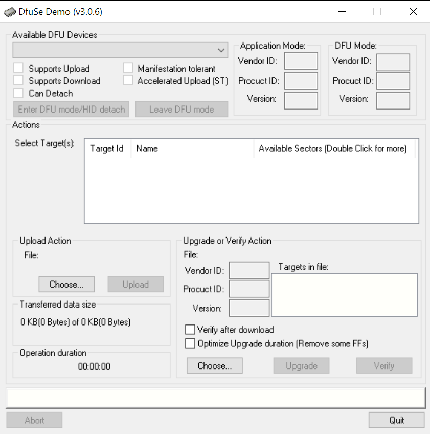

I have similar problem, I really don't know what happened. I haven't been able to detect my sensor for 2 days.
I used to be able to detect it in the Tera Term, now the port can't be detected, at all when I pull out and insert the usb cable, windows doesn't recognize the change...
I've tried to retrieve the clues from this side, but in Dfuse can't choose anything. See image.

Hi @Community member​ , pls check also the DFuSe demo drivers are not conflicting if you may have installed the STM32CubeProgrammer. Regards

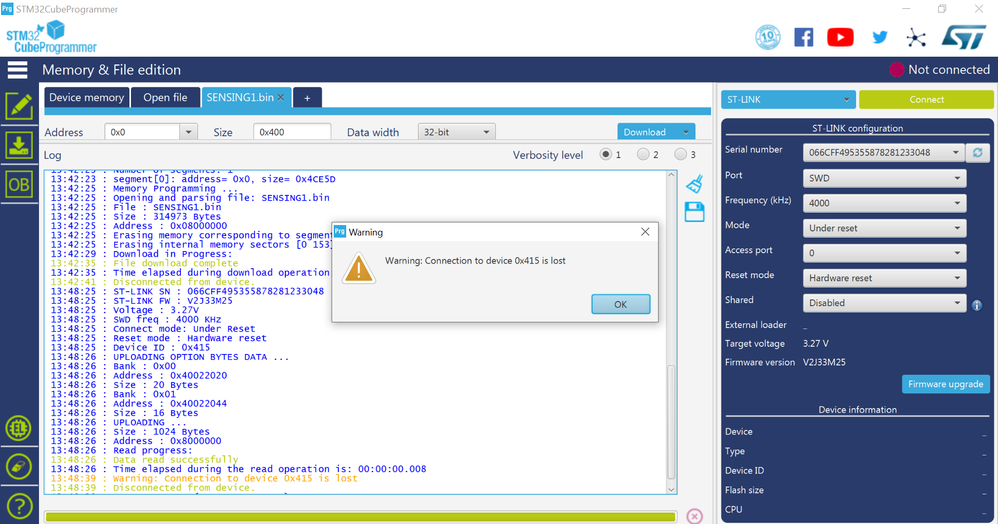

First of all, thank you for very fast respond. Yes, indeed I have STM32CubeProgrammer.
I will present my current status because I am really lost and stack.
I think that I am able to connect to SensorTile via ST-Linker due to STM32CubeProgrammer because when I switch it off I got "Warning: Connection to device 0x415 is lost". When I upload a SENSING1.bin I cannot find sensor via ST BLE app.
Moreover I am not able use UART, and my Windows 10 does not see a SensorTile, I see only ST-Lineker port.
If you use the STM32CubeProgrammer (directly using the .bin files) you have to uninstall the DfuSe package. Then please check if you are following the instruction at this LINK, second part. Regards
Thank you very much, actually I guess that problem came from last update. I don't understand what really happened, however finally CleanSENSING1.bat helped. I can reach my SensorTile again! Thanks for your help
