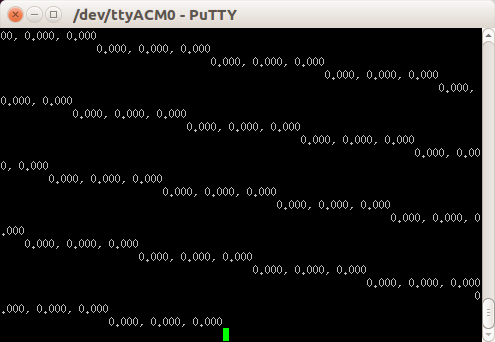

I'm trying to read data from gyroscope. I set ctrl2_g and I'm trying to read 6 bytes from register address 22h. But in result I receive only 0 values.

	  size = sprintf((char*) data, "%.3f, %.3f, %.3f\n", read_LSM6DSO_G[0],
			  read_LSM6DSO_G[1], read_LSM6DSO_G[2]);
	  HAL_UART_Transmit(&huart2, data, size, 100);

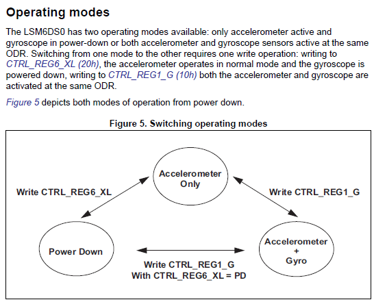

Miroslav BATEK
The gyroscope in LSM6DS0 cannot work standalone you have to enable also accelerometer.
Thank you for your answer. Thanks to it, I've realized that there is difference between LSM6DSO and LSM6DS0 and I had used wrong datasheet. Now my program works properly.
