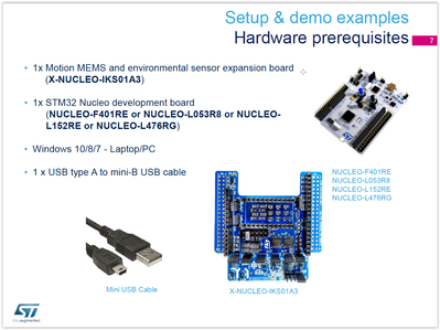

‎2024-02-15 8:34 PM
Thank you for your reply.
I have found it in x-Nucleo-iks01a3_quick_start_guide
However, I have checked the latest supported boards in MEMS1 library folders and they are :
NUCLEO-F401RE
NUCLEO-L073RZ
NUCLEO-L152RE
NUCLEO-U575ZI-Q
Can you confirm this?
Best Regards,
Pepe
‎2024-03-05 1:37 AM
Hi @pepebisup12 ,
Yes, the boards you are loooking are not supported by X-CUBE-MEMS1. NUCLEO-L476RG used to be supported, that is why it is mentioned in the getting started document for X-NUCLEO-IKS01A3 but it is not supported anymore.
