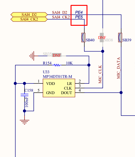

Problem with enabling onboard MEMS microphone using SAI interface on STM32H735IG discovery board

Eleon BORLINI
Hi @PZare.1​ Pawel,
I checked internally with our experts, and they suggest to check the settings of the pins: the mic is connected to PE4/PE5, while you are configuring the PD6/PE5.
0693W00000AMGE3QAP.pngBefore checking in more details your configuration, please see what happens changing the two pins, and let me know.
-Eleon

Hi @PZare.1​ ,
do you have the possibility to check the PDM data (and then the PCM stream) with a scope?
-Eleon
Hello Eleon,
I checked signal on PE5 pin (SB40 on your board schematic) - clock is clocking with 133kHz frequency, on pin PE4 (SB39) there is always 0 V.
Pawel
