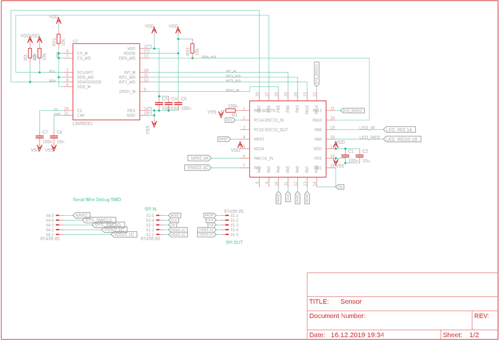

I am using the lsm9ds1 with a selfmade circuit, but I could not get any data from the sensors. The I2C works fine. I can access the registers, read and write to them and get an acknowledge from it, but when I read the data registers, the values don't change even when bdu is disabled. Does anyone know what problem could be causing this?
schematic:
IMU setup:

2020-01-14 6:26 AM
Hi @Ole Thomsen , you have to explicitly enable the 3 axis of the gyro writing '1' in Zen_G, Yen_G, Xen_G of CTRL_REG4 reg
>> CTRL_REG4 (1Eh) --> 1Ch // datasheet p 50
and do the same for axl enable bits in CTRL_REG5_XL reg
>> CTRL_REG5_XL (1Fh) --> 1Ch // datasheet p 51
