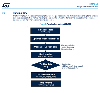

Found a potential bug or issue with the Ultra Lite Driver (ULD). In my application I was calling `vl53l7cx_check_data_ready()` and subsequently `vl53l7cx_get_ranging_data()` as fast as possible, but if I slow down this update rate to, say 10 Hz, the sensor stops producing the stratified distance measurements.
My assumption from this flow diagram was that `vl57l7cx_check_data_ready()` would return false until the data was properly processed and was ready for consumption.

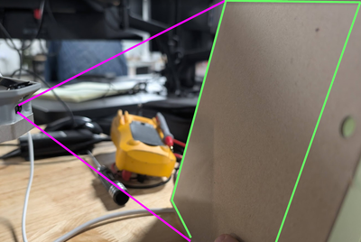

Dec 23, 2025 10:39 PM UTC
Unfortunately, the issue didn't resolve itself. I'm still seeing the distances jump "around"  - stratify into discrete magnitudes.
I'm printing the target_status of all 64 zones and i'm seeing mostly 5's, with no indication on why the distances jump even though the target is static
Photo of setup
