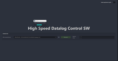

I am trying to do USB sensor data streaming Real Time Plot by conecting my steval mkboxpro with hsdatalog_GUI.py but it keeps saying "Device Template Model Loading". Anyone can help?

I already have the FP-SNS-DATALOG2 fw flashed on sensortile.box Pro board, Python 3.12 installed, and the HSDPython_SDK installed.
But when i execute hsdatalog_GUI.py it detects the board, but keeps giving the message "Device Template Model Loading"
