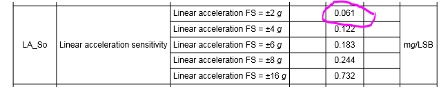

All the sensitivity values for the acceleration fit within 16 bits, however  �16 g does not.
Let�s use FS �2 g as an example sensitivity level.  As the range is -2 to +2, this would be a total of 4g.  Or 4,000 Milli-Gs.
The output is 16 bits. 16 bits equals 65,535.   This means we can get 65,535 different readings for the range  between -2 and +2. (or -2,000 MilliGs and +2,000 MilliGs)
4,000 MilliGs / 65,535 = 0.061
0.061 is what is seen in the datasheet for
�2
here are the values for all sensitivity levels;
�2  =
�4  =
 8
,000 MilliGs / 65,535 = 0.122
�6  =
 12
,000 MilliGs / 65,535 = 0.183
�8  =
 16
,000 MilliGs / 65,535 = 0.244
�16  =
 32
0.488
The only one that doesn't match up with the datasheets for both LSM9DS0 and LSM9DS1 is for
�16.  The calculations above show 0.488, but the datasheets have 0.732
Can someone please explain why this is so?

It is not uncommon that the output values doesn't cover the whole 16-bit range of output registers. From that reason the sensitivity is listed in the datasheet.
Basically it means that the resolution is lower than 16-bits.
You have to use the sensitivity mentioned in the datasheet to get correct acceleration value.
