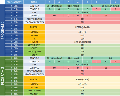

This should be a question with a simple answer, but for some reason, I cannot find clarification. I am trying to use the Finite State Machine in the LSM6DSOX, and I have come across these examples below in this application note:
I'm confused on how to determine the THRESH1 values that are in the programs above. From what I read, the FSM uses the same linear acceleration sensitivity value as is output to the host MCU. As an example, my understanding is that I would take 3C66 (from program 2) as the number of LSBs, multiply that by the linear acceleration sensitivity value (i.e. 0.061 mg/LSB for FS = +-2g) and then that would be how you get the 1.100g that is in parenthesis. Doing the actual math with the different linear acceleration sensitivities for the different FS values, I don't find any of them equating the 1.100g.

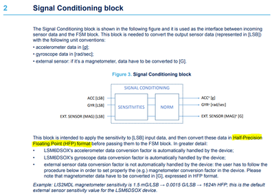

As written in the AN5273 the FSM works in floating point on 16bit:

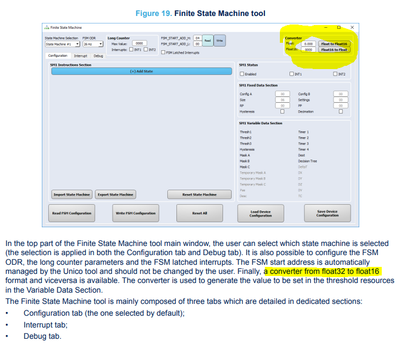

For the conversion you can use Unico GUI or MEMS Studio:

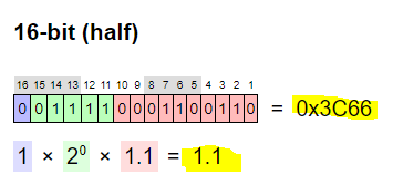

In alternative, you can also use this website: https://evanw.github.io/float-toy/ :
0x3C66 is 1.1:
