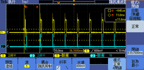

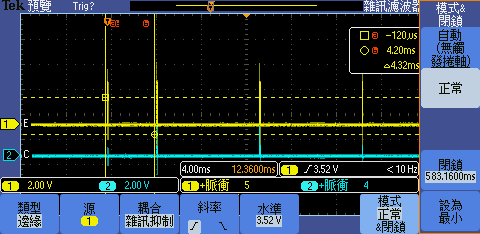

Dear Sir,

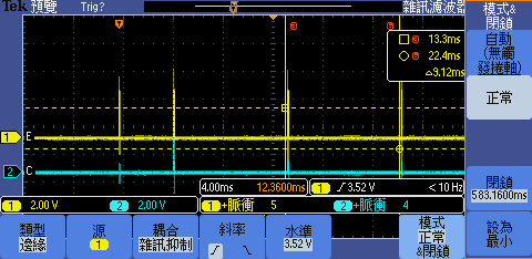

Here set XL ODR = 104 Hz and Gyro ODR = 104Hz, routing XL data-ready to INT1, Gyro data-ready to INT2, respectively.
Interrupt mode is set to pulse mode here.
Do reading XL register and gyro register on INT1 and INT2 for clearing data-ready interrupt event, respectively.
After registers are programmed, use scope to view the waveform.
Except the 1st XL interrupt, the span between remainding adjacent interrupt is about 9ms, is approximately to XL ODR 104Hz, as expected.(see Fig.2)
Why the span between 1st XL interrupt and 2nd XL interrupt is weird? it is about 4.3ms (see Fig.1)
Yellow channel(channel 1) is XL interrupt
Blue channel(channel 2) is Gyro interrupt
0693W00000aJ5m2QAC.pngFig.1 weird 1st XL interrupt, span between 1st XL interrrupt and 2nd one is about 4.3ms
0693W00000aJ5mCQAS.pngFig.2 span between 3rd XL interrupt and 4th one, is about 9ms

Dear All,
I found that swap the order of setup to enable XL ODR and Gyro ODR, the weird 1st XL interrupt disappears.
ie, swap the latest two setup order
But still don't know why?
