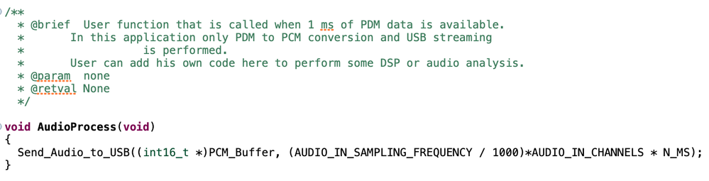

AudioProcess is the right callback, where 1ms of audio samples are ready to be used in your application.
How are you saving the files? If it is a .wav, have you added the proper header and description in the file before opening it and start saving data?

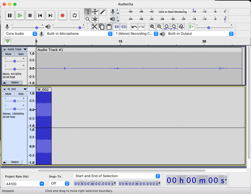

I'm using the STM32L476RG board and a MicroSD breakout board for the SD card. I'm using SPI to communicate with the SD card, which works fine.
My issue is saving the PCM data into an SD card. The sample code provided uses the USB interface. I thought it would be straightforward since a function transmits the data over USB. I could just take the PCM data and store it on an SD Card instead of over USB.
When I play back the audio, I get a lot of noise.
0693W00000aIJ4vQAG.pngW_002 is the data stored on the SD card, and Audio Track is audio transmitted over USB.
I've been trying to store the data in the PCM buffer on0693W00000aIJ4lQAG.png the SD card.
Is it possible to store the PCM data on the SD Card, or must something else be done before I can save it onto the SD card?

Hello Simone @[SPRAD.1]​ ,
Yes, I added the proper header and description in the .wav file before opening it and saving the data. I even saved the data on a text file and imported the raw PCM data into Audacity. Both files had the same noise.

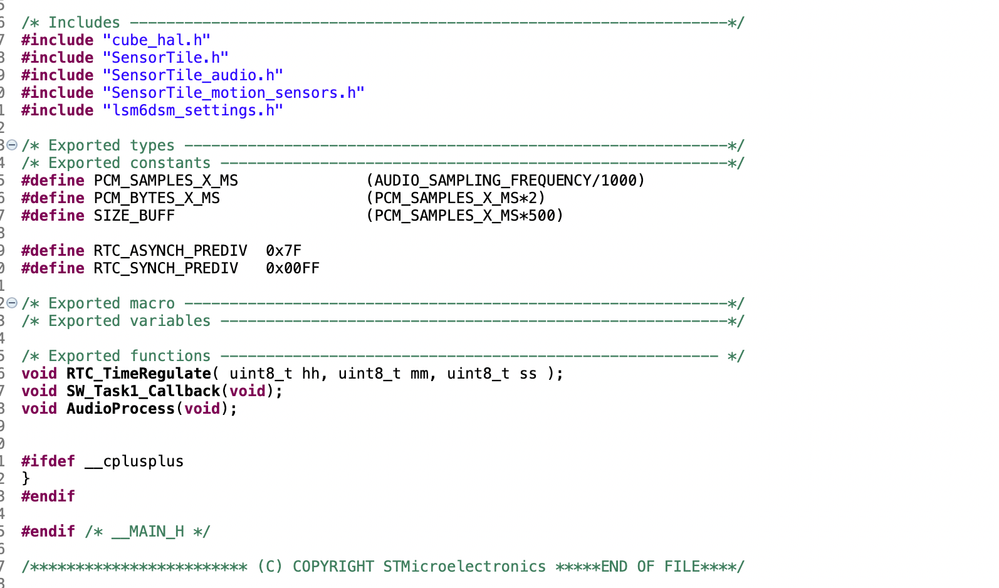

When I set the SD card buffer size to uint16_t Audio_OUT_Buff[(((AUDIO_IN_CHANNELS * AUDIO_IN_SAMPLING_FREQUENCY) / 1000) * N_MS)*500], I get an ram overflow error when sampling at 192 kHz. I think the sample code is set to 16 kHz. I haven't tried 16 kHz because I would have to desolder a connection on the STM32L476RG as per the X-NUCLEO-AMICAM1 documentation.
Are ye multiplying by 500, so that the buffer size is half the sampling rate?
The screenshot is the main.h file.

Hello Simone @SPRAD.1​,
I got it working.
I'll just have to use a board with more RAM if I want to sample at 192 kHz.
