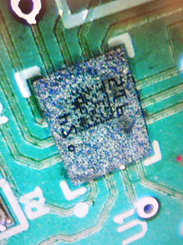

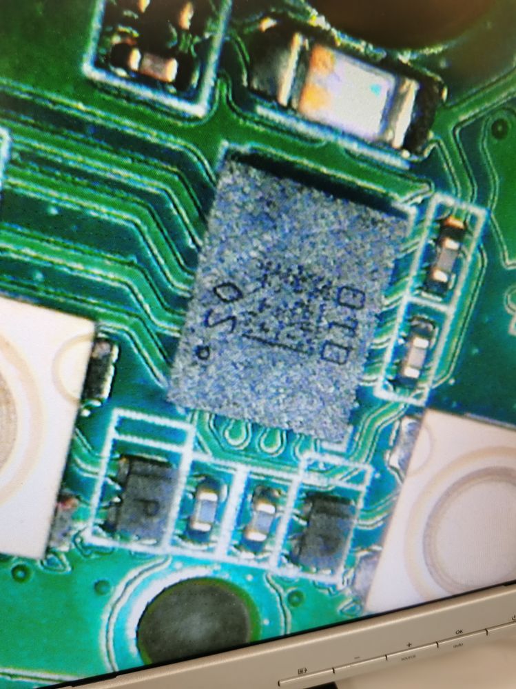

We use two types of sensors for our dev: lsm6dso and lsm6dsox. It is necessary to detect the type of sensor SW (without opening the device). And it's difficult, because adress (we use i2c) is the same, Device Identification (Who am I) is the same for LSM6DSO and LSM6DSOX... and i can't imagine how to easy to detect it

Hi @YRakh.1​ , since the sensors are very similar, you could distinguish them from the top marking. Can you please send me an image of them? No to easy to distinguish them via SW, because they differs only from MLC embedded digital feature (and it is not so easy to simply "enable" it...) Regards
YRakh.1
0693W000001s6i1QAA.jpg0693W000001s6hwQAA.jpgthanks for the quick answer! here are the images:
Thank you @YRakh.1​ . Please condider the two-digit marking near the pin1 dot indicator
  • marking S0 --> LSM6DSOX device
  • marking S4 --> LSM6DSO device
Regards

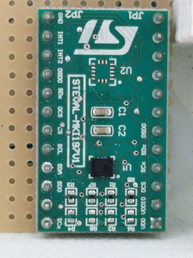

Mmm.. are you sure? i just checked STEVAL-MKI197V1 with LSM6DSOX and on this chip label is S4, but it is 100% LSM6DSOX (if datasheet is ok)
here S4 label:0693W000001s8RbQAI.jpg
probably you messed up the labeling?
Sorry, I have confused. The progression 0-->4 indicates the part number evolution
STEVAL-MKI197V1 --> LSM6DSOX --> S4
STEVAL-MKI196V1 --> LSM6DSO --> S0
regards
