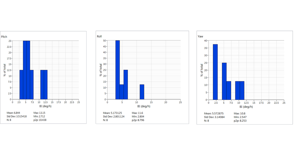

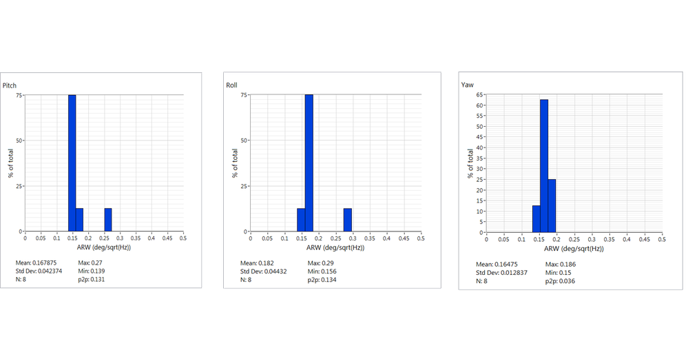

The random walk and bias stability of the LSM6DSM gyroscope could not
be found in the data sheet.
Random walk , bias stability of gyroscope Please tell me the reference value.​
Eleon BORLINI
Hi @totaw.1​ ,
AVAR parameter are not fully tested in the inline tester production, that's why they are not in the datasheet with upper and lower spec limits.
I can however share bench results on a representative sample, tested in the following conditions:
VDD = 1.8V
VDDIO = 1.8V
ODR XL = 208Hz HP
ODR Gyro = 208Hz HP
Synchronous reading
Temperature Range -40 ÷ 85DegC
Angular random walk of gyroscope:
0693W000007ZjWoQAK.pngBias stability of gyroscope:

Is there a unit problem of Angular random walk of gyroscope in your answer ?
I expected the data in "deg/s /sqrt(Hz))" or in deg/sqrt(h) ?
