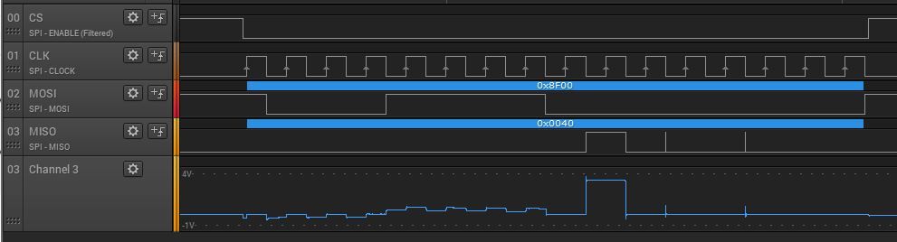

SChin.2
Hi @Eleon BORLINI​
We have got the new part since the last one was got damaged because of 5v supply on VDDIO
But still we are seeing same issue in getting the response for WHO AM I,
SPI Configuration:
  • SPI Freq- 100KHZ
  • Slave Select - Active low
  • CPHA- 1
  • CPOL - 1
  • bit order - MSB first
sent 0x8F00 on MOSI line and seen 0x0040 and it was random some times we are seeing 0x007F as a response.
