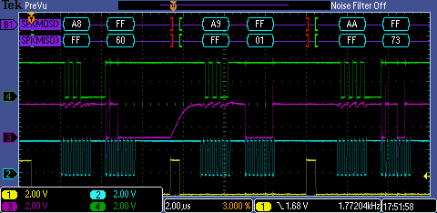

When I send two characters the pattern is:
So the signaling form is okay. At 5.25 MBaud I'm not buzzing the chip. The values that I'm getting out make sense.
I checked the wave forms on the three byte version (read | multiple | xlow, read | xhigh, dummy) and it looked good, nothing violated, but the data did not change.
Andrei

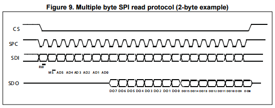

Okay, I figured it out.
According to the timing diagram in the data sheet, bit 0x80 is the R/W bit, and 0x40 is the M/S bit, with bits 0x3F being the address bits.
In real life, there is no M/S bit. The diagram is a cut/paste from a previous generation of some  other chip.
To read multiple bytes, you set the address increment bit in control 6 and just keep sending clocks.
If you set the M bit 0x40, suddenly you are just reading other registers. This device has registers in the 0x4x-0x7x range, and you just end up reading them.

Posted on May 30, 2017 at 17:19
I think you are right the Figures 7, 8, 9, 10, 11 in
DocID022405 Rev 2 (Datasheet for LIS3DSH)
are not correct because the bit 1 is not the M/S but is MSB of the register address. I asked sensor specialists to confirm this and fix the datasheet.
I don't see this issue in the datasheet for LSM6DSL
Concerning the default value of CTRL_REG6, it is not mentioned in the table 15. I think you mistake the default value with binary representation of the register address. But you are right in the section 7.7 the default value of ADD_INC is not mentioned. This bit is set to 1 by default.
