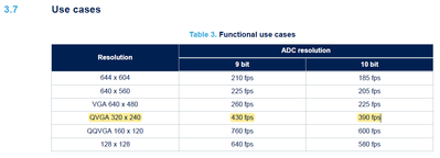

Thanks for the reply. Just a follow up question on the higher frame rates. Are the stated frame rates (e.g. 500 fps for 320x240 px) still possible to reach using sub sampling? Or should we expect some other limits?
2024-11-06 12:54 AM
Hi Simon, higher framerate for 320x240 can be achieved with subsampling as section 3.7 in DataSheet.
