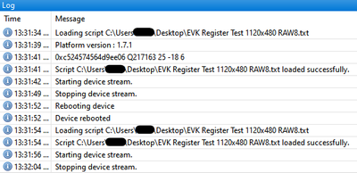

I am using the STSW-IMG501 software v1.1.1 with the STEVAL-EVK-U0I connected to a STEVAL-56G3MAI (the S-board evaluation module for the VD56G3).  In the EVK software, I am using the built-in script generation tool to upload different register configuration sets and test them.  However, I find that uploading the following script will cause the SW to fail to read a frame sequence:

The SW only fails at 1120x480 if it is the first script uploaded after powering on the sensor and booting up the SW.  If I instead start at 1120x1360, run that for a little bit, then switch over to 1120x480, it works great.  Because of this, I don't think there is anything wrong with using that specific resolution when selecting a ROI, just when starting with that resolution after powering on.
Is there a reason that this happens?  I am using the evaluation platform to verify different register configurations before uploading them to a custom built sensor PCB, but am concerned that there is something wrong with starting at specific resolutions when using the sensor.  Is this a bug in the SW, or will the image sensor itself also fail to stream data when configured at different resolutions after power-up?

I have tried the script on my side is ok before launch any script please be sure to press button "reboot",
on the script there is no boot sequence only sensor configuration
Could you please try?
Regards
astral256
Rebooting the sensor did not change the displayed behavior by the software.
To reiterate my process, I plugged in the sensor, I loaded the software, I loaded the script, I tried to capture frames (and failed to), I rebooted the sensor from the software, I reloaded the same script, and I tried to capture frames (and still failed to).  Here is what the output of the log looks like:

What you are doing seems to be correct. Could you please clarify what you mean by “the following script will cause the SW to fail to read a frame sequence”? Are you seeing an error message? It would help us better understand the issue.
Thank you, Megane
