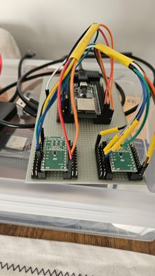

Hello, I am using the LIS2MDL development kit. I have two questions.
  1. When I measure with two development kits in the same environment, I get different values.
    Both are 5 cm away from each other and there is no factor that will disrupt the magnetic field around either of them.
    What could be the reason for this?
  2. When I bring a magnet closer to any of the development kits without changing its position and move it away, I get different measurements than the first values ​​it measured.
    For example:
    x: 500 y: 100 z: 800
    After moving the magnet closer and further away:
    x: 200 y: -200 z: 450
    When I reset the card nothing changes. It still reads the bad value. The position of the development kit does not change and I guarantee that the magnet is far enough away.
    What is the reason for this?

Hi @AlpoTemi ,
Are both development kits configured the same? Such as ODR, operating mode, FS, and so on.
In order to better understand the issue, could you please send us the kit configuration and some output raw data? Are you able to read the WhoAmI register correctly from both magnetometer? And please share also a picture of you setup.

By how much do they differ?
As @AlpoTemi said, some example data and some good, clear photographs of your setup would help.
AlpoTemi
Sure. My configurations for both sensors are the same.
I have no issues with any reading or recording configurations.
The photo is for informational purposes only about my work environment.
I take my measurements without any magnetic interference around me. I even make sure to keep it well away from my phone or computer.
I will send you my outputs within a few hours. Don't forget to keep your notifications on. Thanks
