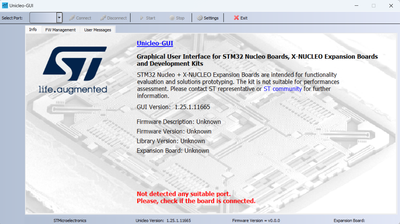

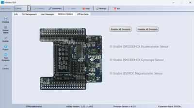

I selected every sensor each board has on the x-cube-mems1 (package) and build it using CubeIDE (no error or warnings), but the Unicleo-GUI shows only the X-NUCLEO sensors, being unable to switch between (for example) the different Gyr/Acc sensors.
If i dont select the board extension IKS02A1 CubeIDE gives no trouble (0 error and warnings) but the Unicleo-GUI doesnt recognice my board and i get stuck here:
(note: If i select to list all coms it appears, but shows nothing and cannot start)

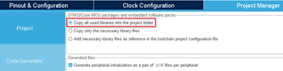

Sorry, I was testing some new unofficial CubeMX version and it modified the ioc. Unfortunately I have to say there is most likely some regression in CubeMX v6.11.1. After some modifications the project works but only in v6.11.0 and in unofficial v6.12.x.
Please completely uninstall v6.11.1 and then install v6.11.0 from st.com. Attached is the suitable ioc. Here is what I've changed to compile with 0 errors 0 warnings but maybe in 6.11.0 it could work without the changes, I didn't try.
There is also warning (in X-CUBE-ALGOBUILD v1.3.0) which points out that in demo_serial.c file in void Report_Error(uint32_t err) function the uint8_t buffer[24]; array has to be actually uint8_t buffer[260];. After fixing that you should generate correct FW. This has been fixed in v1.4.0 already.

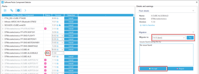

Have you updated capabilities.json/xml files to reflect your HW? Get the inspiration in example Projects in X-CUBE-ALGOBUILD package. Then you could try to migrate X-CUBE-ALGOBUILD to v1.4.0 in CubeMX before project generation (if not done already).

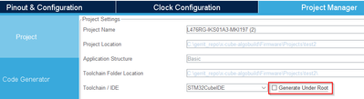

@aesteban it's hard to say without having it. Please share both your generated firmware template which you copied into the firmware_template MEMS Studio directory (including ioc) and also your complete AlgoBuilder project.
‎2024-05-24 3:47 AM
Okay, I send you the debug project I used to isolate the issue and a .7z with the generated template.
