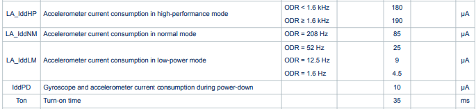

What is current consumption of Gyro sensor in sleep mode?
What is wake up time from sleep mode? (sleep mode mentioned in AN5125 para 3.5 & DS12171 rev 3 Table 3 section 4.2)
Thanks for your help
1 REPLY 1
Eleon BORLINI
Hi @CHarr.1​ , as described in the datasheet p.11. The first three rows are the current consumption of the ISM330DLC device with gyro in sleep and axl working, the next row both gyro and axl in sleep condition, and the last row the turn-on time (the wake-up time is a little faster than the power on time, but are the same order of magnitude).
