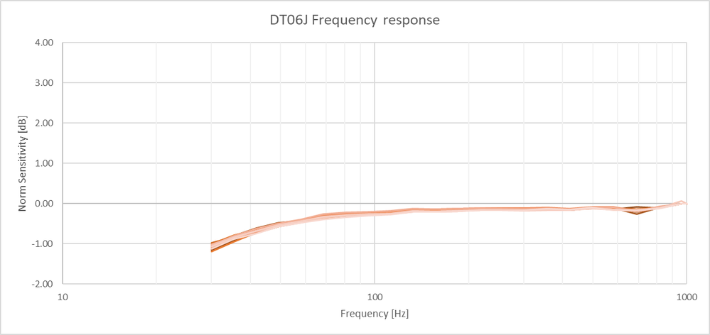

Hi, do you have data and information about infrasound characteristics of MP34DT06J
I looked at its frequency response in the data sheet, but information is being plotted starting from 100 Hz only.
I'm using the CCA02M2 board.
Many thanks!
3 REPLIES 3
Eleon BORLINI
Hi @MSant.1​ , what do you mean with "infrasound" characteristics? The usual characterizations is performed in the [20Hz, 20kHz] band, so I can share you a typical frequency response in this range from characterization lab. The FR is almost +-2dB flat down to 30Hz.
Btw which is your target application?
Regards

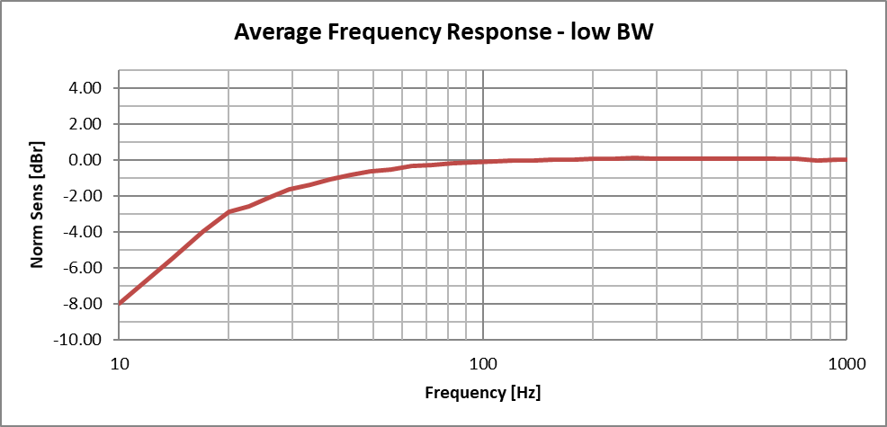

MSant.11
Hi, sound from combustion processes may be in infrasound range, i. e. below 20 Hz. This is my target application.
Hi @MSant.1​ , ok, I can share you the average behavior down to 10Hz, because the standard detailed characterization is limited to 20Hz.
