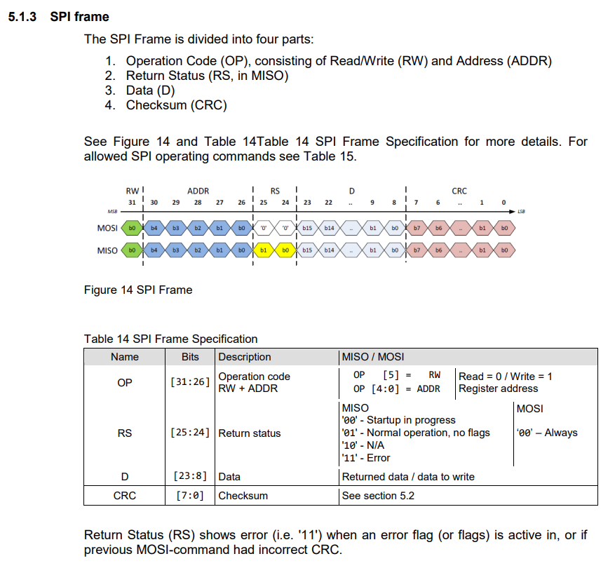

Hi, I solve a problem with reading more parameters from the inclinometer Murata SCL3300. The communication works without errors, the init state is OK and when I read more parameters, I get the wrong results.
For SPI communication I use HAL_SPI_TransmitReceive(&hspi2, tx_data, rx_data, 1, 100); I attached my code.
Does anyone have the same problem?

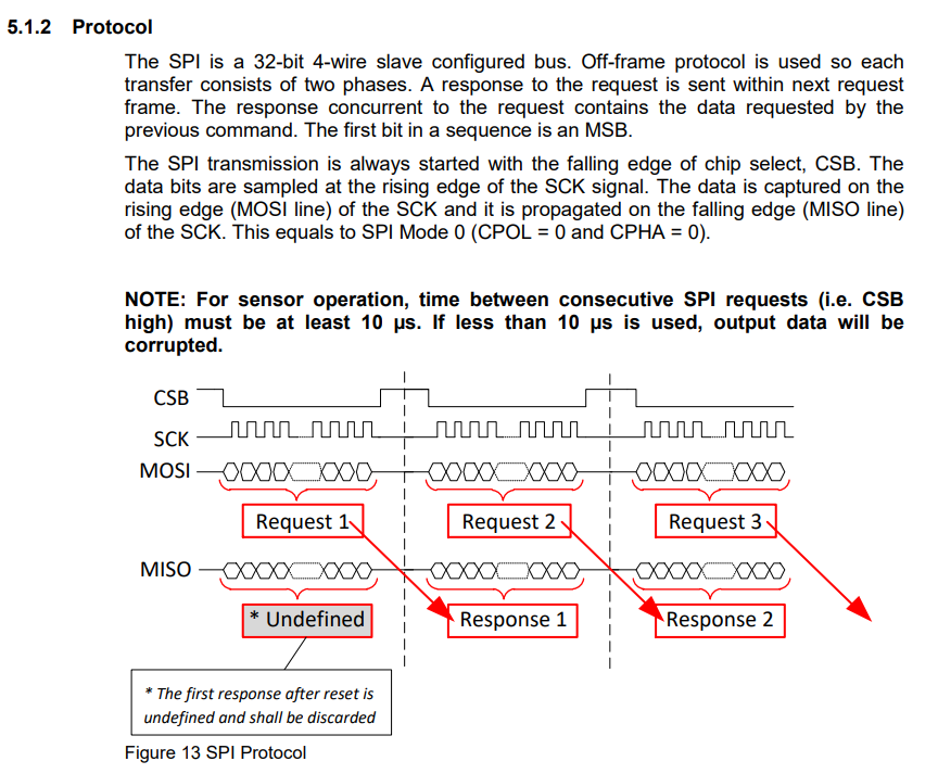

The problem was in reading data. Responses are shifted as shown in the datasheet. The data reading code should look like this:
// first command
transfer(RdAngX);
if (crcerr || statuserr) errorflag = true;
// second command
transfer(RdAngY);
// response to the first command
angleX = (SCL3300_DATA / 16384.) * 90.;
// third command
transfer(RdAngZ);
// response to the second command
angleY = (SCL3300_DATA / 16384.) * 90.;
transfer(RdStatSum);
angleZ = (SCL3300_DATA / 16384.) * 90.;
transfer(Read_WHOAMI);

I think the problem will be in using the function HAL_SPI_TransmitReceive. The protocol needs to send 4 bytes and receive 4 bytes (see screens from the datasheet). In my case, I use this code:
for (int i = 3; i >= 0; i--) {
tx_data[0] = dataorig.bit8[i];
status = HAL_SPI_TransmitReceive(&hspi2, tx_data, rx_data, 1, 100);
dataorig.bit8[i] = rx_data[0];
The first parameter read OK (for example TiltX), but the second is invalid (e.g. TiltY). I think, there is a collision in the data flow. Is there any description of the function HAL_SPI_TransmitReceive?
Thank you. Tomas
