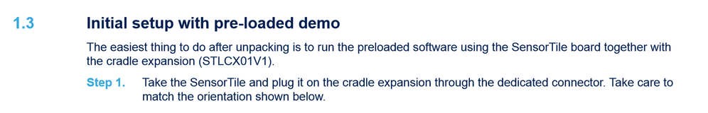

The handbook of STEVAL-STLKT01V1 SensorTile says there is a demo have pre-loaded in the SensorTile board. As screen capture below shows.
I downloaded the new code in the board, so that demo code has been erased. I'd like to get that demo and download it again.
