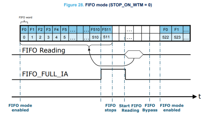

In absence of specific details about the issue, would first suggest you to read LSM6DSOX application note, FIFO modes, from p.101.
0693W00000HpDgjQAF.pngYou can then have a loot to the Github examples in C, such as the lsm6dsox_fifo.c: these drivers implements the registers' settings, buffer reading and parsing in order to implement the FIFO mode on the LSM6DSOX.

It should be OK, setting the FIFO mode this way. However, please pay attention to the gyro speed, which is quite high and which could cause the FIFO filling to fast without time to read it.
