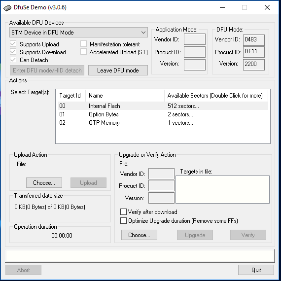

Hi Eleon,
One thing I would like to confirm is when I use DFU File Manager, what should be the Target ID and Target Name? Unlike Figure 12 on p.16, there is no Target ID 00, right?
In addition, I am following the steps up to "open the DfuseDemo app and check if your device is recognized". However, the device is not recognized.
I guess the ST.box is somehow broken?
Hi @DWang​ , you should get a screen similar to this one:

Hi Eleon,
DfuSe Demo didn't detect my device. "Available DFU Devices" didn't list out any device... I still suspect the hardware is somewhat broken...
May I know where to get "Data recorder" app?
Ok, so actually I don't exclude the ST.box could be damaged, in this case...
