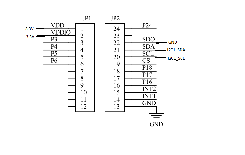

How to connect MKI197V1 to NUCLEO-F756ZGT via I2C but without an expansion board.
AGile.2
The problem is that the address of the device is unknown, I tried 0xD4, D5, D6, D7, A6 and many others, zero reaction.
To check, I use the function:
#define SENSOR_ADDRESS 0xD4
if (HAL_I2C_IsDeviceReady(&hi2c1, SENSOR_ADDRESS, 2, 10) == HAL_OK)
  HAL_GPIO_TogglePin(Green_led_GPIO_Port, Green_led_Pin);

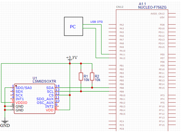

HI @Eleon BORLINI​ ,
It was possible to connect, my mistake was that I did not apply +3.3V to SDA and SCL.0693W00000GXUheQAH.pngThanks for the help:)

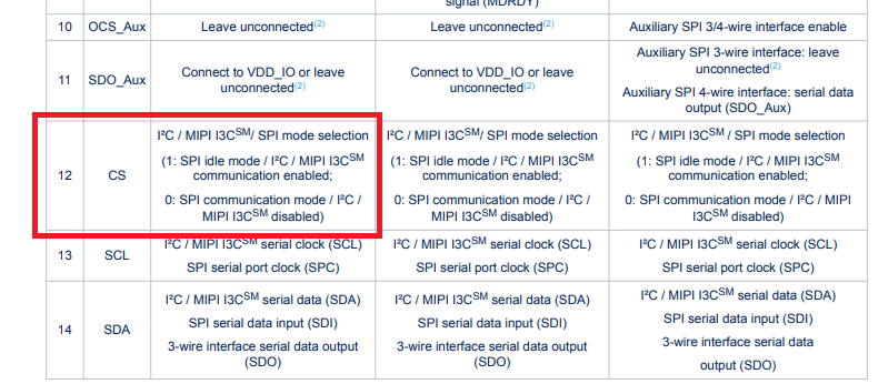

Hi, if you use the I2C you have to set at least the CS to GND (pin19). Suggestion is to follow also the recommendation of the datasheet.

Most likely the opposite, CS to 10693W00000FDxanQAD.pngbut unfortunately there is still no response from the sensor.

Hi @AGile.2​ ,
right, the CS has to be tied to Vdd in the I2C.

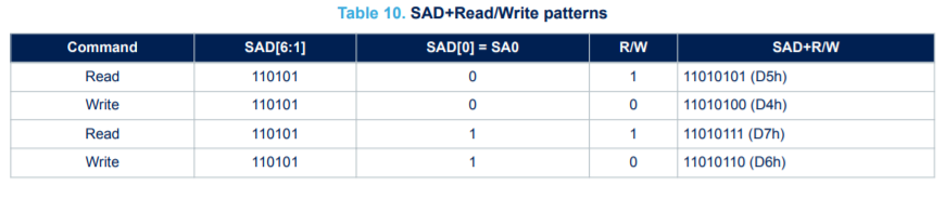

You might try with a 7-bit address, for example 0x6A or 0x6B, from the table:
0693W00000GVnreQAD.png-Eleon
