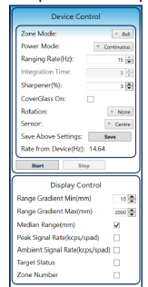

I try  STSW-IMG037 software with  Nucleo STM32-F401RE + Expansion board with VL53L7CX+ two Brakout Boards(VL53L7CX).but it dosen't work. STSW-IMG037 software with  Nucleo STM32-F401RE + Expansion board with VL53L7CX is OK.Soft ver v2.2.29327. and 53L7A1_MultiSensorRanging.bin in X-CUBE-TOF1 is OK.What should I do?

STSW-IMG037 GUI soft can control  three VL53L7CXs in user manual .In user manual GUI soft has select sensor list box. but My soft has non. LPn lines are another port of STM32-F401RE. Another soft(53L7A1_MultiSensorRanging.bin in X-CUBE-TOF1) is OK.This Problem is only STSW-IMG037 GUI soft.
The GUI is supposed to be able to control 3 sensors - but not at the same time. Did you find the sensor setting on the device control panel?
8 down from the top is where you set it.
I don't have an L7 and two satellites, Or I'd try it.
Let me know if it's a question of not seeing the setting or if it really doesn't work.
then I can have someone look at it.
- john

You are correct. The L7 GUI code was modified to remove the option for satellite boards. It was a mistake.
I will have it fixed as fast as possible.
