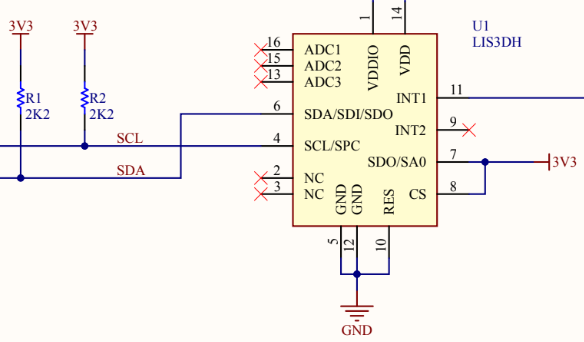

I need to communicate by I2C my board that contains the LIS3DH accelerometer with the MKI109V3 adapter board. In order to evaluate if the sensor readings are correct.
From what I understand, the MKI109V3 evaluation board allows communication via SPI and I2C. But, still not able to do it by I2C.
In my project I use the following signals:
SCL
SDA
While the signals:
SDO/SA0 (connected to 3V3)
CS (connected to 3V3)

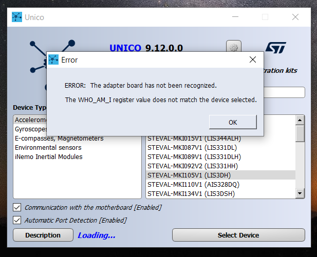

0693W00000Nt78JQAR.pngAnd I am using Unico-GUI software version 9.12.0.0
And I have the following response.
0693W00000Nt78TQAR.pngI would like to know what I have to do to establish I2C communication between my board (slave) and the MKI109V3 board (master).

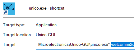

But well, there is indeed a workaround that you might use to overcome the issue of starting in SPI more. You can create a shortcut for Unico-GUI, adding in the Target (properties) the command -setcommi2c.
0693W00000StkaqQAB.pngYou can check whether it is working and see if this was the issue.
-Eleon

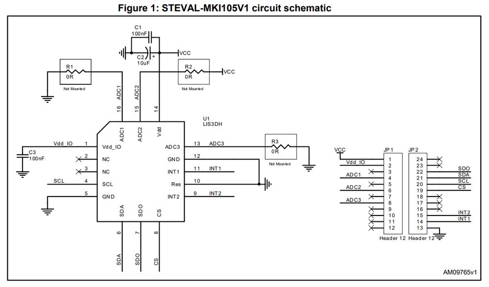

My suggestion is to take inspiration (or copy) the schematic -or at least the connection- of the DIL24 adapter for the LIS3DH (STEVAL-MKI105V1).
0693W00000QKUInQAP.pngIn particular, I would leave the CS and the SDO/SA0 pins being driven by the Unico GUI.

For this project it is impossible, because the accelerometer communicates with other components through I2C and therefore I cannot modify the design.
-Eleon
This is great, thank you! Now, is there a similar command line option to set the VDD/VDDIO voltage?
