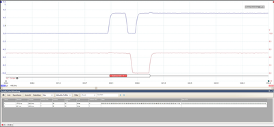

unfortunately we are stuck in implementing VL53L5CX on our PIC18. We see a strange clock stretching behaviour of the sensor and problem downloading the firmware.

Please see the oscilloscope measurements:
Why the ACK from the sensor comes so late for each data byte transmitted from MCU to sensor?
Why sensor accepts the first chunk of firmware data but refuses any further data by replying with NACK on I2C?

Hi John!  Thanks for reading and giving tipps!
The half spikes seemed to be a bad zoom behaviour of the picoscope software in measurement window.
Its not showing the full high levels when zoomed-out (overview). In real, those spikes go up to VCC voltage. This can be seen when zoomed-in to those spikes.

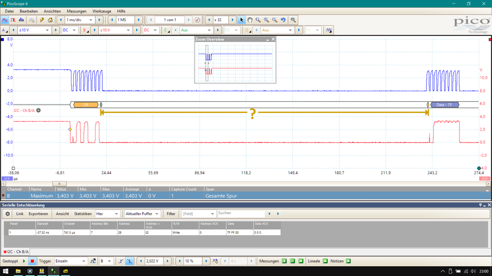

For a test i put all voltages to 3.3V and i still dont understand why the ACK comes so late on the I2C-Bus.
I marked it YELLOW in the measurement graph below:
Is there a special start-up mode of the sensor? May it be, that it started up in a low-speed mode? Or was something wrong with the I2C lines at RESET time of the sensor? Didn't i read once about a Bootloader mode of the sensor, when both I2C lines are low at RESET time?
WHAT CONDITIONS MAY CAUSE A DEALYED ACK FROM THE SENSOR?

As you can see in the graph all voltages are now between 0 and 3.3 V and it can't be an overvoltage behaviour.
For testing i modified my program to wait 5s after start-up before Initialization attempt of the sensor begins.
This allows me to manually RESET/POWER-CYCLE the Sensors supply voltage directly before init routine starts to be sure, no unwanted signal changes on I2C lines occur during MCU reset.
The same sensor PCB stil. works fine and flawless when connected to my ST NUCLEO Eval kit and demo program. Something must be different.
And in the above screenshot its the first data bytes sent on I2C and already delayed. So it cant be a protocol data problem. Something electrically must be different. I2C operates at 400 kHz.
