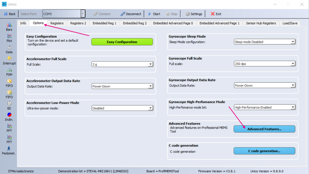

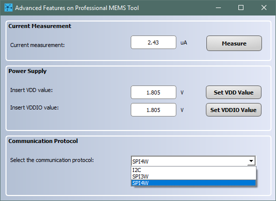

How do I get the STEVAL-MKI168V1 IIS2dh accelerometer DEMO to run in I2C mode instead of SPI. I need to evaluate transfer speeds using I2C. Is there a way of telling the UNICO software to run the sensor in I2C? Thank You!
Lmile.1
Eleon BORLINI
Hi @Lmile.1​ ,
I just got the answer from our experts and well... it's possible at GUI level!
For many devices, IIS2DH included, in the "Option" tab you can find a button “Advanced Features for Profi�?, that allows (also) the communication protocol change.
Please check the picture below for a guide:
0693W000008wsmgQAA.png0693W000008wsmqQAA.pngIf my reply answered your question, please click on Select as Best at the bottom of this post. This will help other users with the same issue to find the answer faster.
-Eleon

Eleon BORLINI
Hi @Lmile.1​ ,
-Eleon
Lmile.1
Hi Eleon,
Thank you for answering my question. My Unico user interface doesn't have that "advanced option"
Where do I buy or get this better version of software you have demonstrated?
Thank you again!
Larry
Hi @Lmile.1​ ,
you should be able to find it in Options --> Advanced features as shown in the picture below:
-Eleon
Lmile.1
Hi Eleon,
My demo kit doesn't seem to have the right side menu as yours does?
My software version is the newer 9.9.0.0, how do I download your version. I am trying to
use STEVAL-MKI168V1 (IIS2DS) yours is STEVAL-MKI196V1, a gyroscope? Maybe my accelerometer
doesn't have that menu? Thank you for helping me! Larry

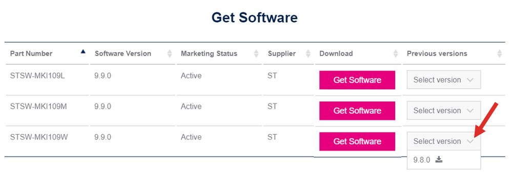

Hi Larry,
that's strange, I'll check better... But it could be related to the fact you are using a IIS2DH (I was checking with an LSM6DSO), and should check if this feature is device-dependent (I supposed it was not indeed...).
You can however try downloading the previous version of Unico (for Windows, for example) from the st.com page:
-Eleon
