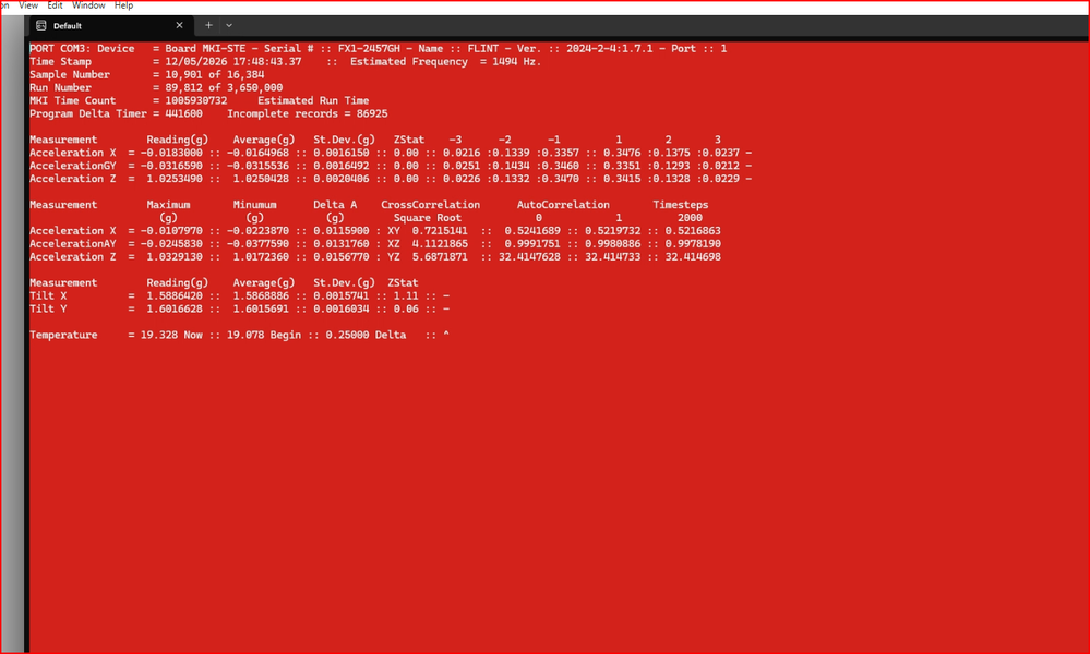

Flint is an accelerometer system in the Smithsonian Museum.
It is a MKI109 and MKI 210 pair.  It has been in place for about three years after a recommendation from your David Reynoldson, who is a really great guy and helps a lot.
We have about six to ten such systems that were used and have now been pulled, but old Flint just keeps on working.
It has a partially bespoke C# program.  The PI designed and manufactured some small boxes. But to hold the 210 onto the 109 I used a rubber band before it was boxed.  It worked well for three years and then broke. Flint had some minor problems:
1. You have to use a USB Managed HUB to turn the device on and off if you reboot the computer.  The HUB is as expensive as the accelerometer pair.  Or you unplug the computer, the device does not reset to home if the computer is switched off - major design flaw in a complex system.
2. You have to put a watcher program to monitor the accelerometer program that can just stop running with no warning.   The new Sensor TileBOX Pro has the same problem.  I have not yet put in the watcher program nor got another USB Hub, so the PRO is a manual pull out the cables.
3. The frequency of the output is not constant, so it has to be monitored every 8 seconds and recorded with the data
and the FFT step adjusted.
4. They have no serial numbers but thankfully the PRO does, the number is so big it cannot be held as int in C#. The number is larger than the number of grains of sand in the world, statistically speaking.
5. It took me a month to work out Flint was not working because of the rubber band and not the electronics.  It now works again.
It will pick up a daily change less than 15 microHz on a degrading structure, which is all structures.  PS Some degrade much faster, even if they are newer.  It will pick up a subway train at half a mile.
Upgrading the programs over a cell modem that runs as a 3 is a pain.
But it is a complex system with only a few annoyances.

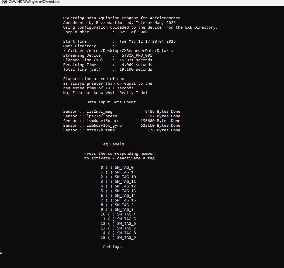

The PRO's revised program
The PRO is great on a USB cable, but it is not as good as the other pair, it is much harder to program because of the C program that is mostly locked.   Of course they are sales toys for ST but for us they are mission critical devices.  Put up the C code for the dll's and allow us to use MSVS and not g++.  I gave up make type files in 1988.

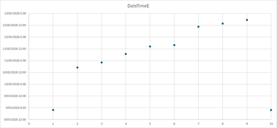

This is the full reboot sequency for the Sensor Tile Box Pro that is sitting on a brick under my desk.  When the period passes one year, allowing for electrical blackouts, then it can be used usefully, otherwise it is just a nice research tool.  Nothing more.  Each dot is a reboot, the period is ten days.
One does not do a Gaussian analysis with one sample, one uses not the engineering three, but at least ten, hence my purchase.  It is a simple analysis to understand this number, 50 is the real number, but life it too short.

The CLI_EXAMPLE locked DLL's are throwing random errors, I cannot fix these errors in your code because I cannot get to the C code.
It is hard to evaluate when they crash at three iterations.
Please help me help everybody who wants to evaluate these devices.
