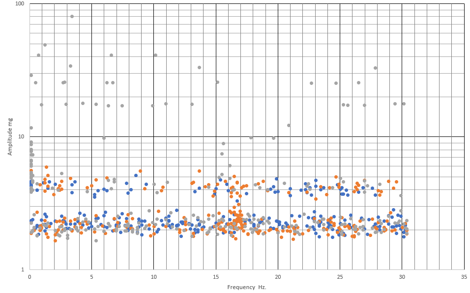

0693W00000SuDPXQA3.pngSmiling to oneself, I had to write the software to read your 109 in a useful format. Your manuals assume a high skill set. The UNICO GUI Lite is a challenge. There is a long step from your board to this graph.
