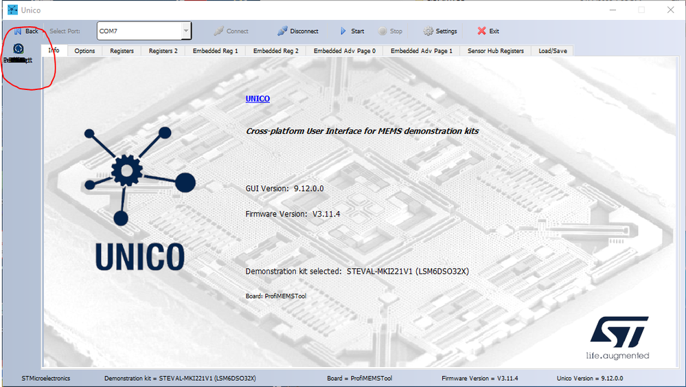

Well, the Unico-GUI software was working fine, and one day all of the tools (bars, plot, data, etc) started getting drawn on top of one another, and the last one (pedometer) is the one on "top" and the only one I can now select. Any idea how to fix this? I uninstalled/reinstalled and it's still doing this...

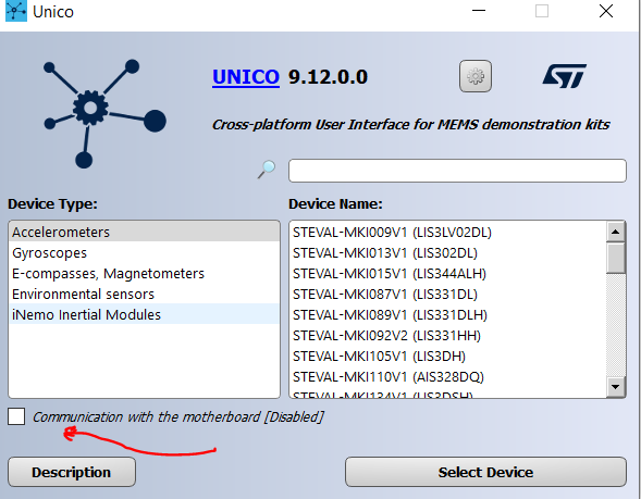

Hi Brian @Brian Rau​ ,
Did you changed the Operating System in the meantime?
And do you see same issue starting Unico "offline"?
-Eleon
