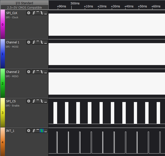

Hi, I'm trying to use the IIS3DWB as FIFO mode with a watermark.
I'm using a custom board. I double checked the hardware and guaranteed this board works well. I'm able to read/write the sensor using SPI interface and generate interrupt with wake-up int source.
To handle the sensor, I'm using the library created by ST. https://github.com/STMicroelectronics/iis3dwb
In this mode the interrupt INT1 not works well. This is my init code:

2021-08-30 5:16 PM
Hi @DSull.3
Many thanks for your reply.
Removing this line "iis3dwb_fifo_xl_batch_set(&hAcc, IIS3DWB_XL_BATCHED_AT_26k7Hz) " the FIFO stops to work.
I set the bit STOP_ON_WTM on register FIFO_CTRL2 to 1 the INT1 started to working. Even with all those INT1 enabled, works without no problems.

I checked with a logic analyzer and the INT1 is happening.
I'll test the results and apply a FFT to analyze the response frequency, but I think this resolve the issue.

2021-08-27 7:18 AM
Hi, not an expert of the topic, but what if you don't set the batch in FIFO? The iis3dwb_fifo_xl_batch_set(&hAcc, IIS3DWB_XL_BATCHED_AT_26k7Hz) line.
And if you set the STOP_ON_WTM bit of the FIFO_CTRL2 register to 1?
I see you also have enabled a lot of interrupts on INT1, can you try them one by one?
