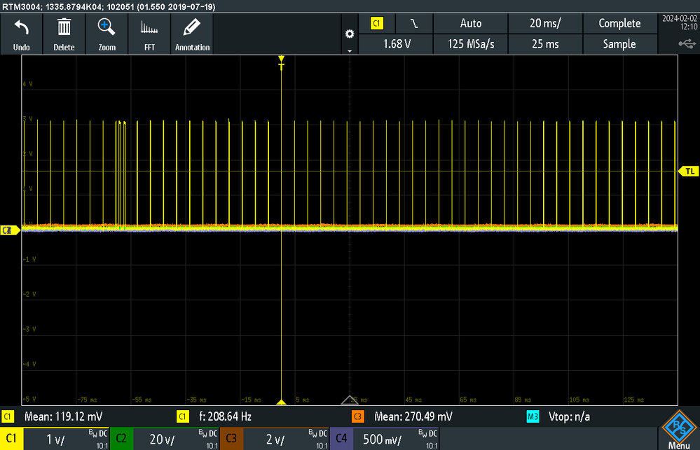

we are using the LSM6DSO in Fifo mode and with the double tap feature. Our firmware configures the Sensor Frontend to give an interrupt at fifo_th on INT1 and for double_tap on INT2. Therefore, we explicitly disabled the INT2_on_INT1 bit inside the CTRL4_C register.
But still we see the the INT2 interrupts on the INT1 line. (See plot)
We always reset the sensor to default. So I guess it seems something is not correctly configured.

Any help or comment would be apreciated.
CWies.1
Found a solution it was the SPI code not the sensor.

Furthermore, if this happens somehow the interrupt pin of the LSM6DSO goes permanently HIGH. Any suggestion?

Hi Federica,
the problem still persists. I have double-checked the example code but still, it is not reasonable for me why the interrupt for double tap on INT2 happens as well on INT1 although it was explicitly switched off. Do you have an example with both interrupts enabled?
kind regards, C.W.
CWies.1
