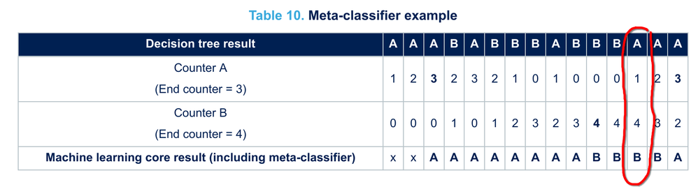

the LIS2DUX12 documentation (AN5903: LIS2DUX12: machine learning core) contains a table explaining how meta-classifier works:
At the third column from the end of the table, the decision tree gives the result "A".
As far as I understand, the "B" counter should have decreased, but it didn't. Why?

Hi @zmogas ,
The counter B should decrease, but the MLC prediction is still B.
Thanks for notice us, we will correct it in the next AN release.
