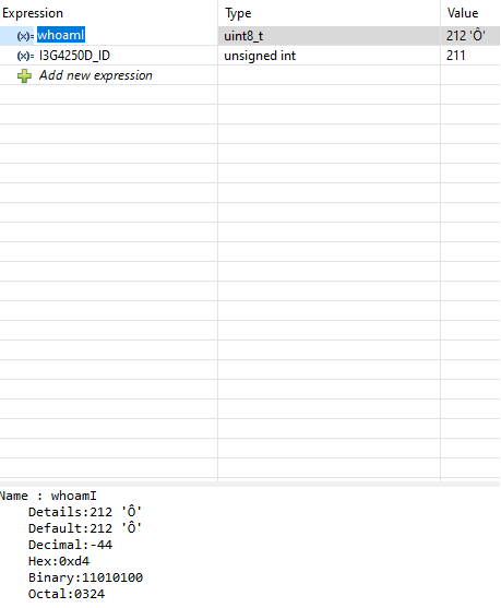

When using this function to read the "WHO_AM_I" register (Address: 0x0FU) I am supposed to get the hex value "0xD3U" (Decimal: 211) but the function call sets the wrong value in "bufp". I get hex "0xd4", following is a screenshot from a debugging session:
 0693W000005AknEQAS.png"whoamI" is the value that gets sets from reading the register and "I3G240D_ID" is the expected value.
In binary the expected value is: 11010011, this is correct according to manual of the gyroscope, but what I get is: 11010100.

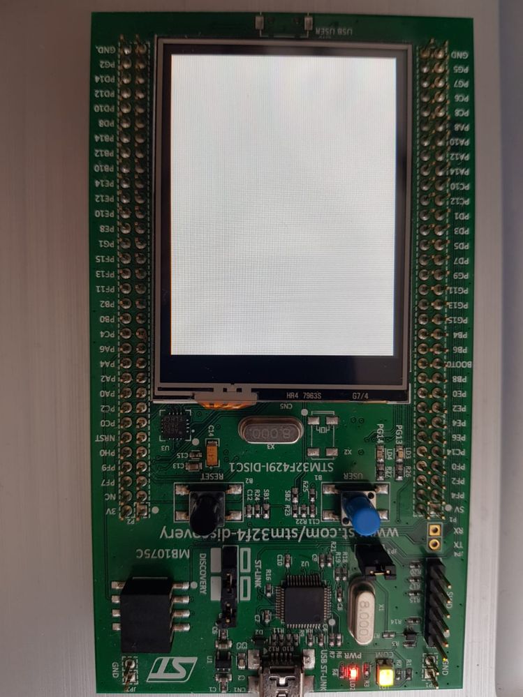

Hi @Eleon BORLINI​ ,
I also do not have access to another mems unit, I'm using the I3G4250D built into the STM32F429ZI (STM32F4-DISC1).
Here is a picture of the board 'm using:0693W000005B2GNQA0.jpgI have also succesfully set and read other registers:
Thanks a lot, this clarifies everything. But before I continue development I have one last question;
The manual of the STm32F429i says that the MEMS unit being used is a I34250D : Discovery kit with STM32F429ZI MCU - User manual (chapter 6.8)
Did I refer to the wrong manual? or is it a mistake in the manual.
Thanks in advance.
No it is the correct manual, but checking the 7.2 Board revision history chapter p.30 you can see that from Revision MB1075 - E01 there is a change:
>> U3: L3GD20 replaced by I3G4250D and R75, C54 added
Maybe the board you have is from another version, the B01 or the C01 (it looks "C" version from your picture, from MB1075C marking)
-Eleon
