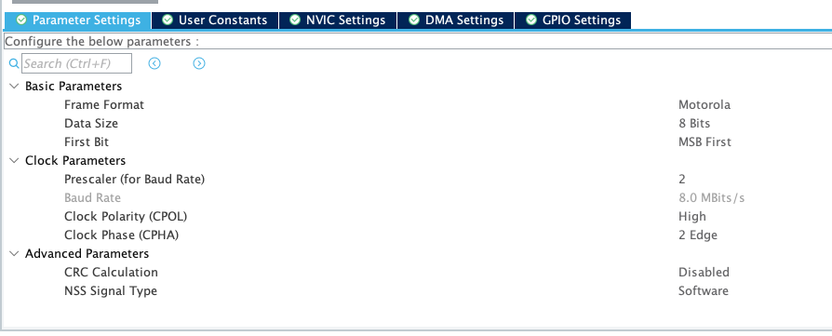

From my .ioc file I've configured things as follows
Data Size : 8bits
First Bit: MSB First
CPOL: High
CPHA: 2 Edge 
Also I've configured PA4 as a digital output to use for CS

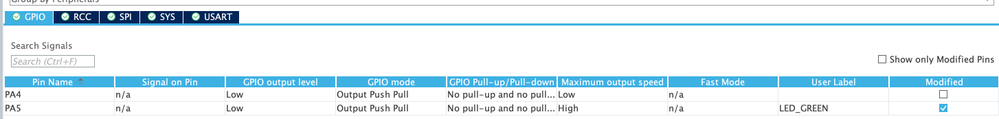

The GPIO settings from the .ioc file look like this
Screenshot 2023-10-20 at 12.42.08 PM.pngScreenshot 2023-10-20 at 12.42.01 PM.png

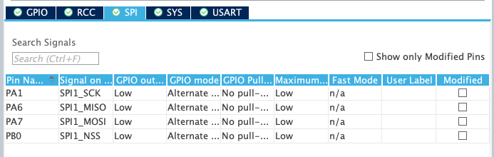

I've also tried a version where I connect CS to PB0 and select Hardware NSS Output Signal
Which gives me SPI GPIO configuration that looks like this
In this case I removed the code from my platform read/write to pull CS low before communicating with it. When I did this I get 0xFF every time.

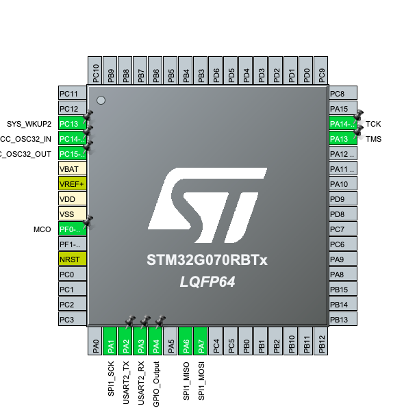

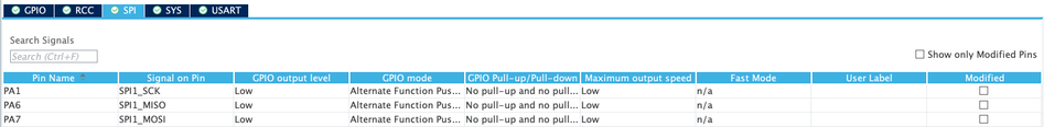

I don't think the PA2 which is connected to the UART2_TX was related to the problem since MOSI in this case is PA7.
 I believe the problem was related to the platform read code needed to set the MSB to 1. Adding Reg |= 80 allowed me to get the correct device ID.

I don't think this had anything to do with it but in the latest working version I also modified some settings for the CS GPIO
