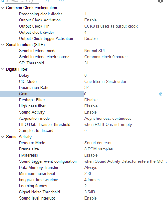

Hi, I have the same MEMS sensor and an Nucleo-U575
I am trying to turn on a light when the sensor hears something using the SAD.
My configuration is as follows:
I have as ADF input clock: MSIK@12MHz
Then a Output clock divider set to 4. So my output clock would be 3MHz.
_legacyfs_online_stmicro_images_0693W00000bhgsJQAQ.pngpins are:
PE9: ADF_CCK0
PE10: ADF_SDI0

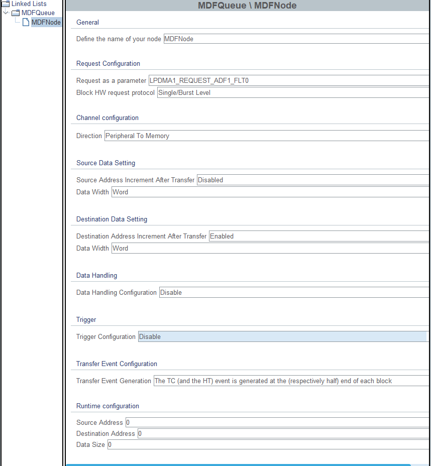

This is the LPDMA section(copied from the ADF_AudioSoundDetection example):
_legacyfs_online_stmicro_images_0693W00000bhgtvQAA.pngAnd this is my callback function

Unfortunately nothing happens.
CBeli.1
My problem is that I keep hitting this error
/* Check if saturation occurs */
 else if ((interrupts & MDF_DFLTISR_SATF) == MDF_DFLTISR_SATF)
  /* Clear saturation flag */
  hmdf->Instance->DFLTISR |= MDF_DFLTISR_SATF;
  /* Update error code */
  hmdf->ErrorCode |= MDF_ERROR_SATURATION;
