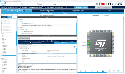

I have a PCB with two microphones (IM66D132HV01) with an STM32U575RGT6 (64pin) micro.
Both microphones are connected (L+R) to a single input {PC0, PC2} = {MDF1_SDI4, MDF1_CCK1}
Firstly I cannot find any example code that produces output samples in the MDF1_Filter3->DFLTDR,  MDF1_Filter4->DFLTDR data registers -- they are always zero.
I can get the MCU to produce a clock signal and I can see a data bit stream coming to the MCU, from the microphones.
As I was a bit stuck, I resorted to using CubeMX to hopefully get some working code --- however -- with CubeMX the common clock was no longer visible.
I also notcied that if I set up MDF1_F3, and MDF1_F4, that  I cannot tell CUBEMX that actually I only need the 'MDF1_SDI4' input since the two filters share the same MDF1_SDI4 bus (one outputs on low clock, the other on high).
Also,  I'm looking for some sample code that can give me interrupts for each of the left and right samples, as they are generated by the filter or some advice on how to confirm the serial bitstream is valid etc
Nick.
Can you check with this configuration?
The common clock must be selected in the "Mode" window (is the very last parameter), then you'll be able to select "SITF with Common Clock..." as a source.
I know it’s a bit annoying, but in the "Configuration" window CubeMX requires you to select the front selection nevertheless the parameter description above suggest that both fronts can be used.
So, agree with you that there’s a limitation in the tool and that both fronts can be used to trigger audio data from 2 different MEMS microphones.

Nicholas Parker
Thanks for the reply Simone.  The common clock issue was perplexing initially -  I understand that particular idiosyncrasy of the CubeMX now.  I was able to get one of the DMA based examples working.  I think an example where there is a 'interrupt per pair of L+R samples'  (less efficient I know) would be valuable to have available (if one doesnt exist).  I would have gone for that kind of example if it was available rather than struggle through the initial information overload of the DMA and linked lists setup -- on which I still dont have a full understanding. I guess its just more time and reading!
Thanks, Nick
