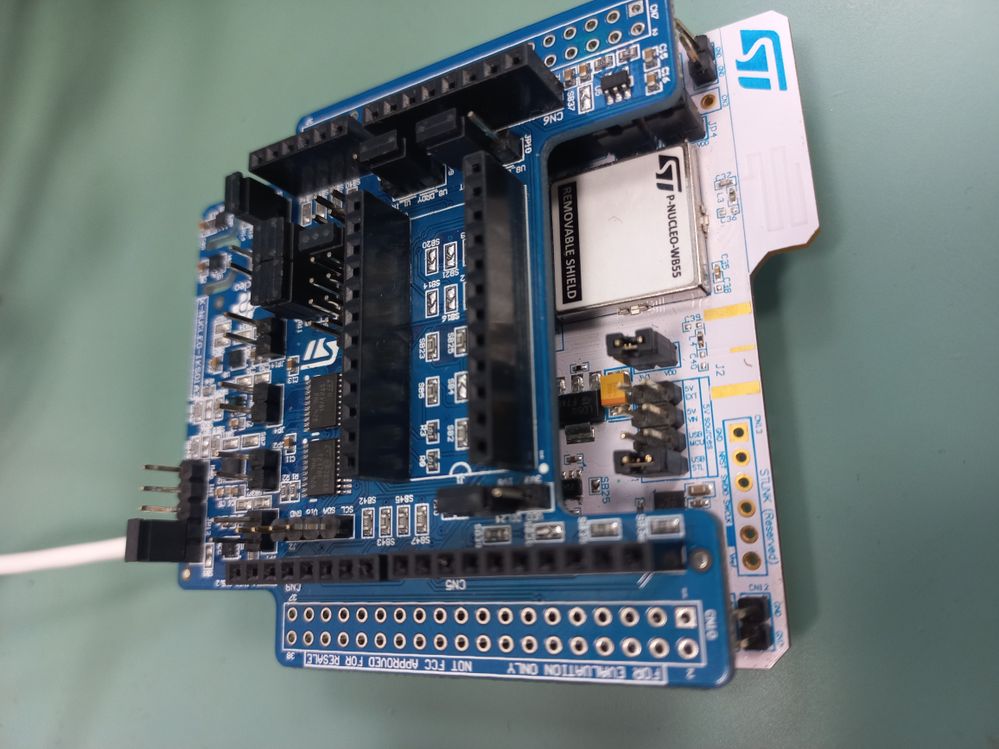

Hi I recently bought a IKS01A3 and want to do research related to human activities. I already have a nucleo-wb55 with me so basically I just connect them via arduino uno V3 ports and willing to set up I2C communication between those two boards. I know there are higher-level drivers and software packs for IKS01A3 board together with fancy UI, but is there a way that we can directly retrieve data according to each sensor unit's datasheet?
I've connected the board's outside connection I2C SCL and SDA (Arduino connector CN10 pin 10 and pin 9) to IC2_1 on IKS01A3 (DIL24 socket pin 20 and pin 21 respectively), and since I2C bus routing are connected as 1-2/3-4(default setting), which means I2C_1=I2C_2 with all devices are on the same bus.

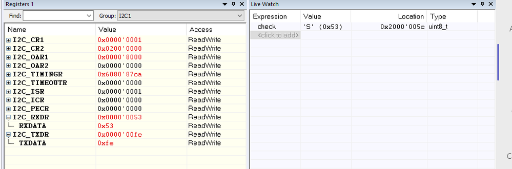

I made the test with the Address given in the datasheet: 0x94 (without shift) and it works correctly.
For example, I managed to read the content of the register " Manufacturer ID " (address: 0xFE) and I get 0x53 as value.
uint8_t check;
  HAL_I2C_Mem_Read_IT (&hi2c1, 0x94,0xFE,1, &check, 1);
  while (HAL_I2C_GetState(&hi2c1) != HAL_I2C_STATE_READY)
Verify first the STM32CubeMX configuration:
  • I2C_SCL: PB8
  • I2C_SDA: PB9
Also, make sure to connect JP13 on the Shield IKS01A3.
