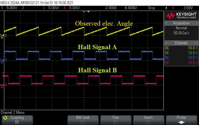

Hi Cedric,
I use 5.4.7 version. Yellow curve is the observed elec. angle and green is the measured electrical angle, However it is difficult to observe the elec angle measured by Hall sensor.

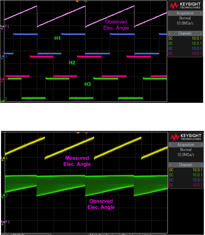

‎2021-10-01 04:55 AM
This is the curve you should observe.
On 5.4.7 it can be observed with the DAC only.
From your picture, the first thing is that your both curves are opposite, This means that your Hall sensors connexion are not Ok.
The second point is that your observed angle go back to 0, could you print your three hall sensors signal ? I wonder if the three sensors toggle correctly.

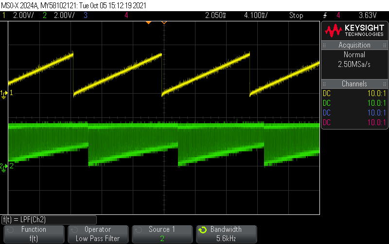

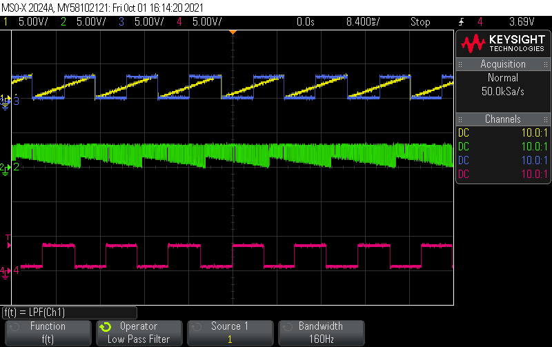

‎2021-10-03 06:40 PM
Hi Cedric,
Since from the previous result, both measured and observed elec. angle are opposite. I changed Hall signal 2 and 3, now the measured and observed elec. angle are in right direction. I measured in both positive and negative direction to see the difference.
in DAC channels, i think Channel 2 is damaged. The signal is not ideal.

‎2021-10-05 12:18 AM
Hi Cedric,
I used 5.Y.2 but still the signal is same. I hope the pin (PA5) in CN10 might get damaged.

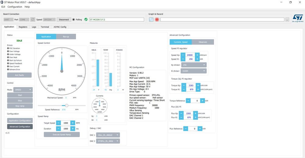

Hello @Community member​
Sorry, I was not clear enough. The purpose of switching to 5.Y.2 and the new Pilot is to be able to see these angles inside the mPilot, and not with the DAC output and the scope.
If you look at the top right of your mPilot screen shot, you have two buttons in the box "Graph and Record". If you click on the graph button, it will open a new window. If you right click inside this window, you will be able to select the signals you want to plot. (HALL_EL_ANGLE & STOPLL_EL_ANGLE)
With the new communication protocol we increased the communication speed so much that we are able now to dump FOC variables at PWM frequency.
It will at least remove your concern about the DAC output pin.
