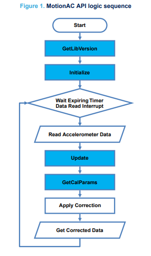

Let's start this diving into the FW libraries for ST motion MEMS sensors with the first one: Motion Automatic Calibration (MotionAC). It provides real-time accelerometer calibration through offset and scale factor coefficients used to correct accelerometer data.
Why should you need a sensor auto-calibration? Because it simplifies and improves the reliability of you application: accuracy is one of the key-words of the state-of-art of MEMS sensors. ST sensor are of course calibrated at Automatic Test Equipment level, but when mounted on the application board, they could need to be finely re-tuned. This will avoid most kind of non-linearity that could impact the performance of your app (offsets, gains, drifts), increasing the complexity of the algorithm and reducing the overall accuracy, maybe misleading the target of the application.
